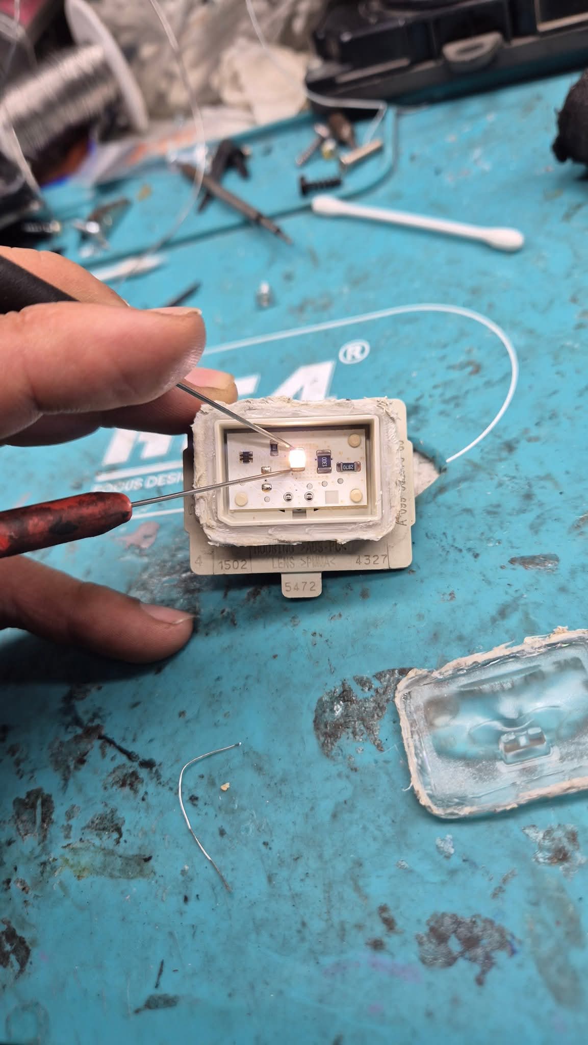

벤츠 E클 W212 트렁크등
LED 고장 고질병 이죠..

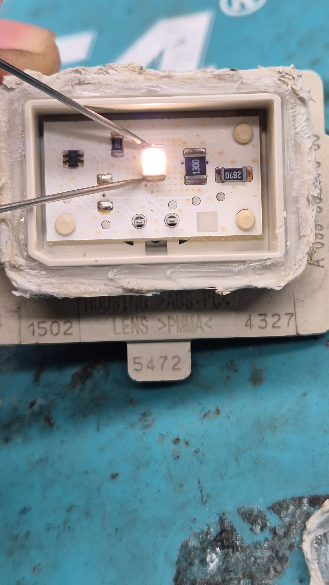

LED 고장이아닌 1300칩 냉납으로
리납 해주시면 됩니다.
The trunk light on a Mercedes E-Class W212 LED failures are a chronic problem..
The issue isn't with the LED itself,
but rather with the 1300 chip that's
causing the problem
You can just leave it as is.
