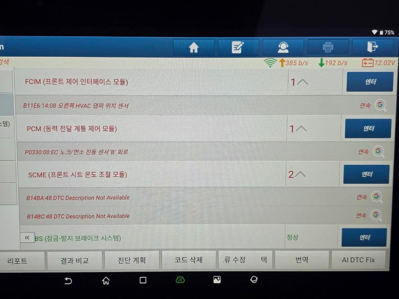

P0330:00.EC Knock Sensor error.

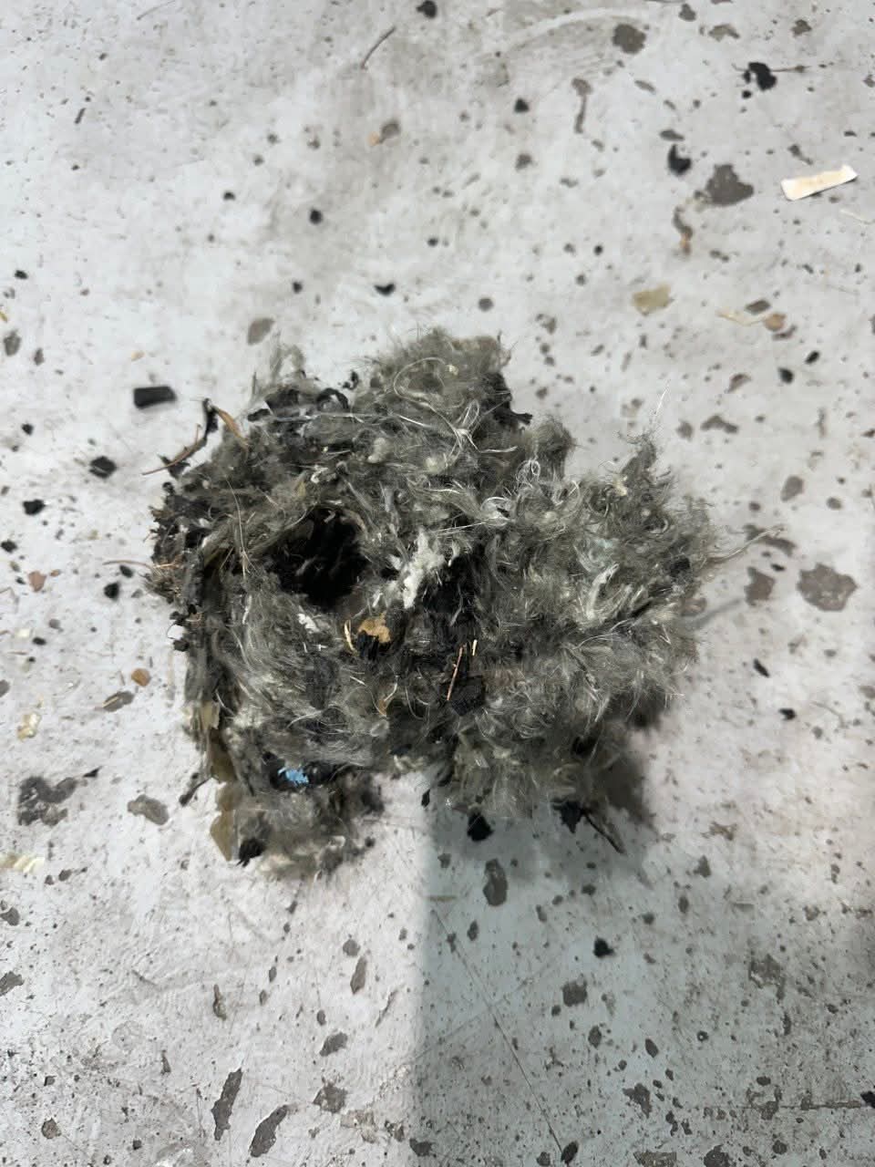

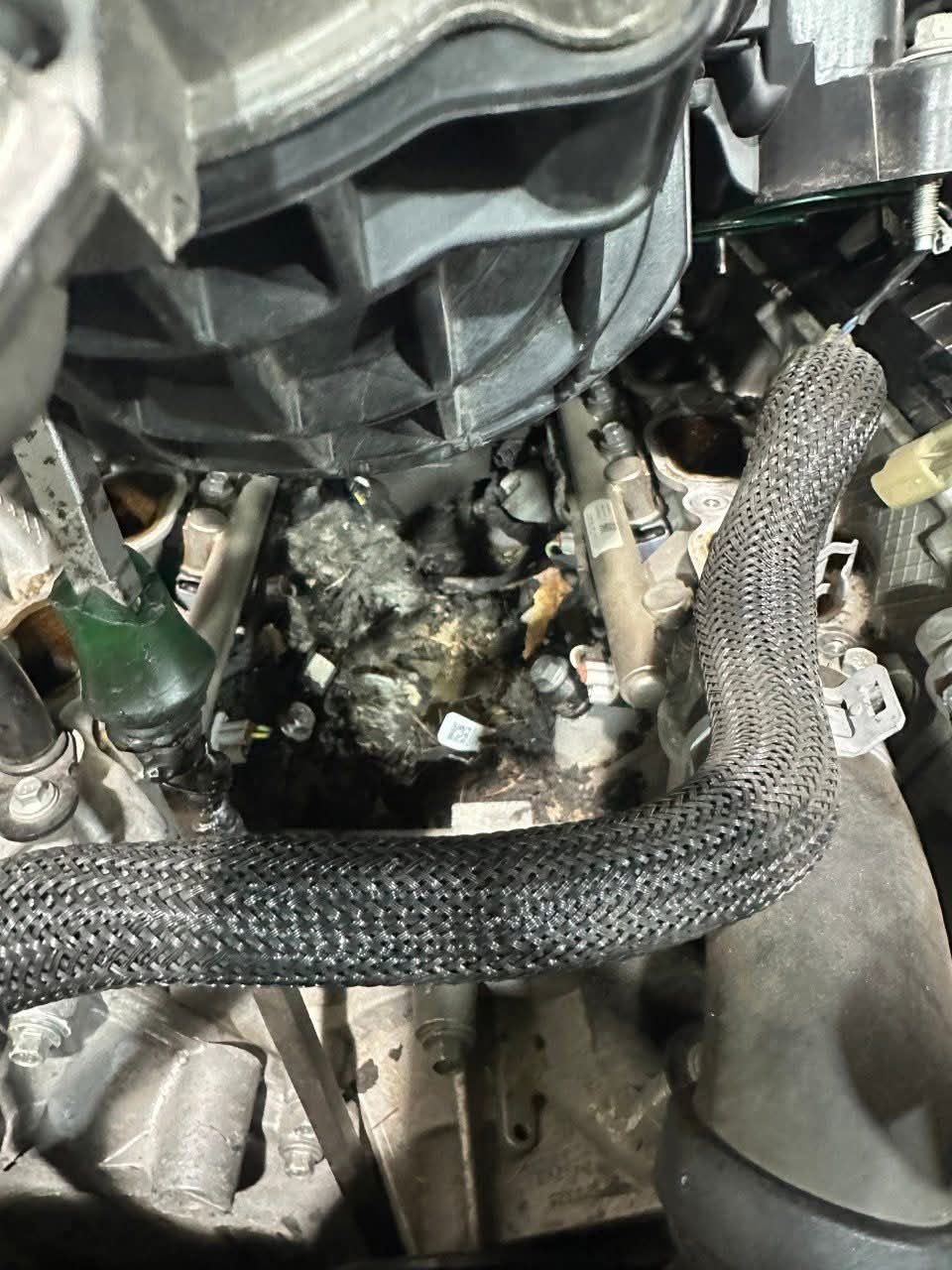

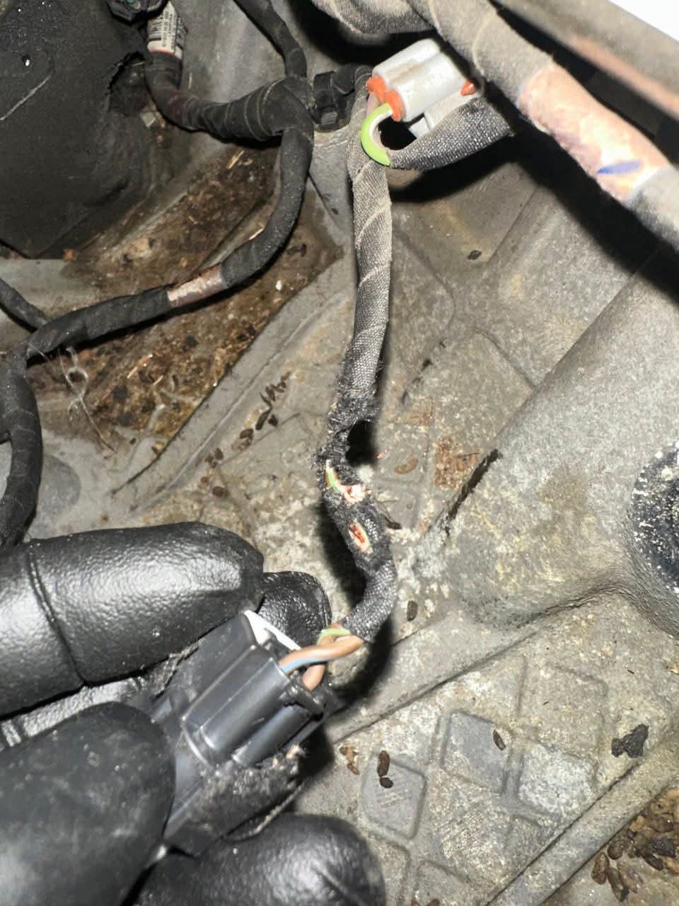

The reason for the cause is that rats have made a home and are chewing through the wiring, causing it to short circuit.
The problem was solved by reconnecting the wiring.
