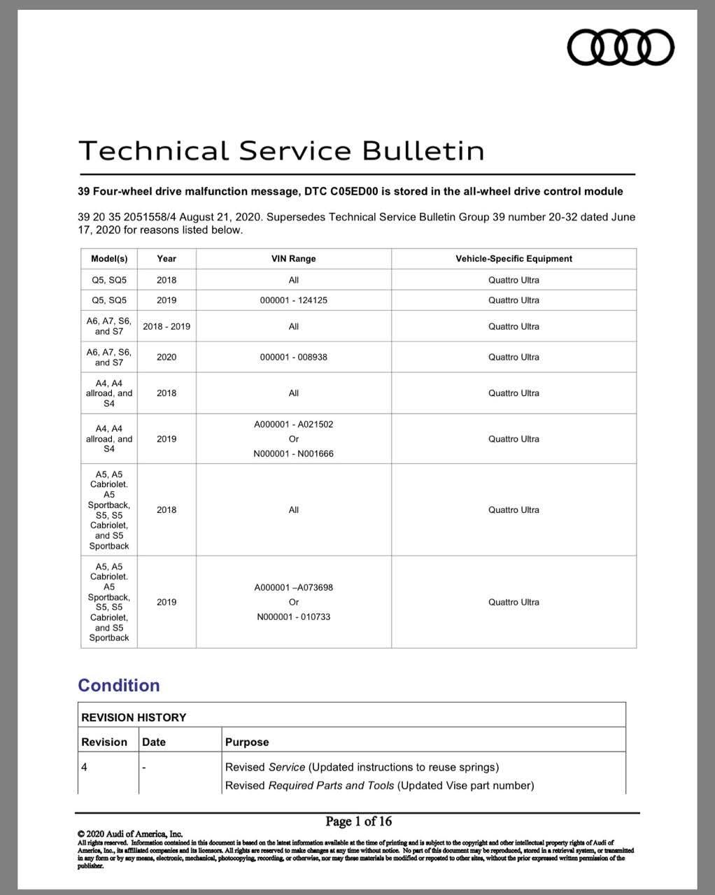

2017~2019년 아우디 a4,5,6,7 s4,5,6,7 q5
고장코드 C05ED00: 4WD/AWD 클러치 'B'가 고착
C05DD00: 4WD/AWD 클러치 'A'의 성능 저하/고착 관련
정비 문서
2017–2019 Audi A4, A5, A6, A7, S4, S5, S6, S7, Q5
Fault Codes:
C05ED00 – 4WD/AWD clutch “B” stuck
C05DD00 – 4WD/AWD clutch “A” performance issue / stuck

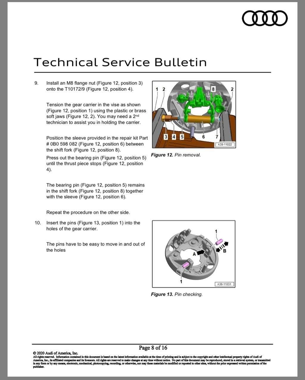

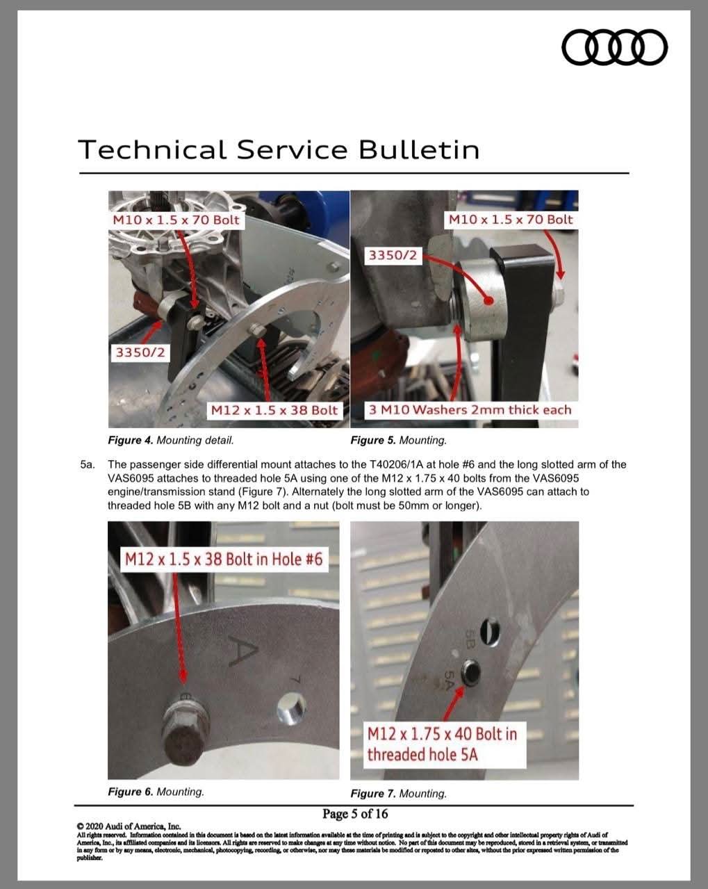

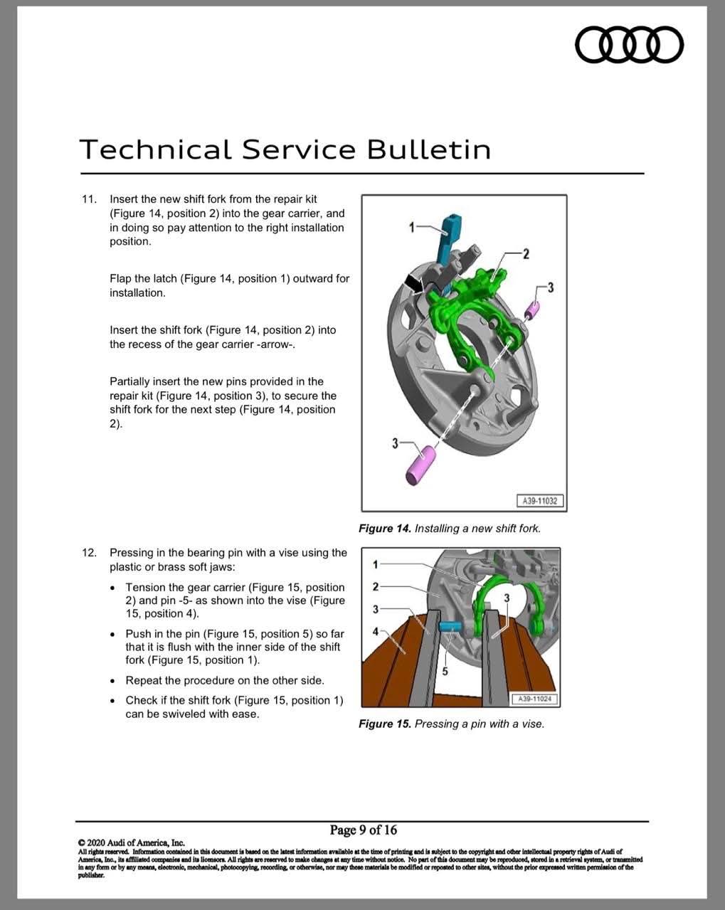

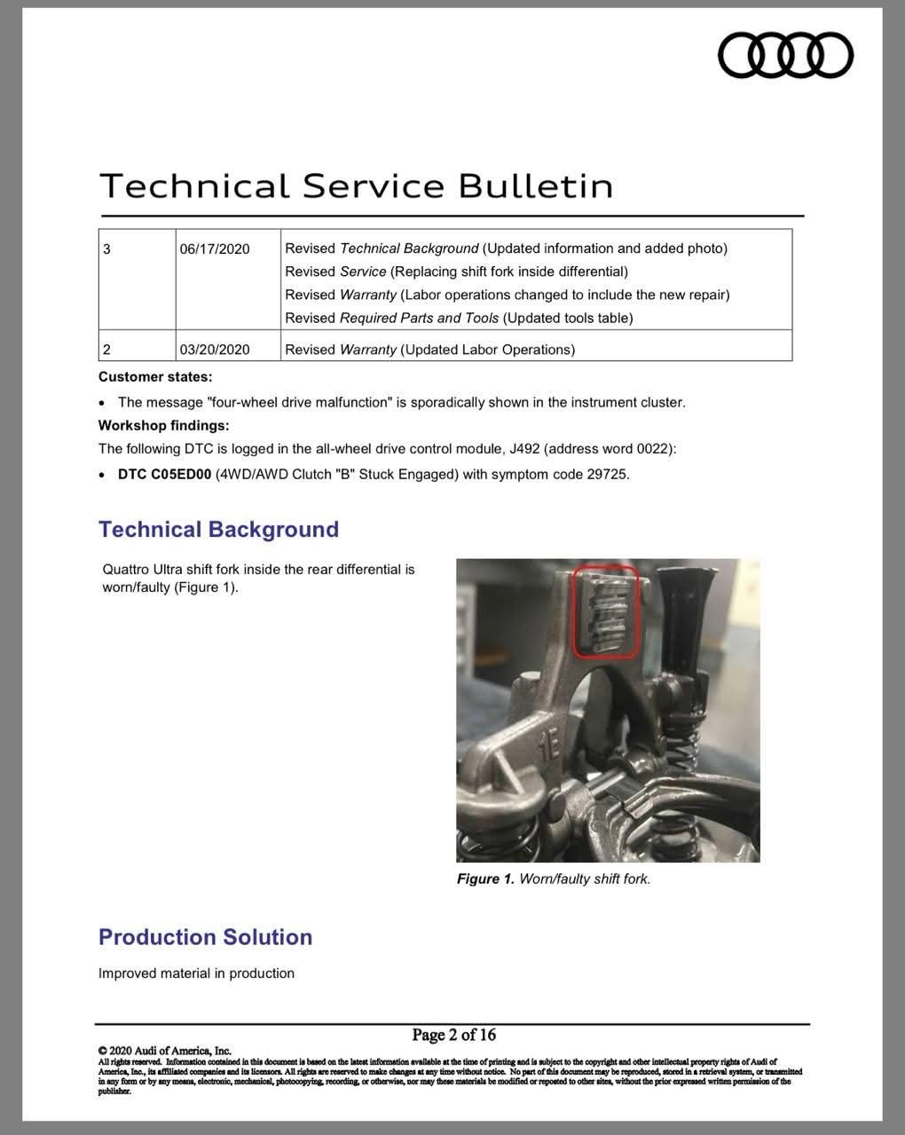

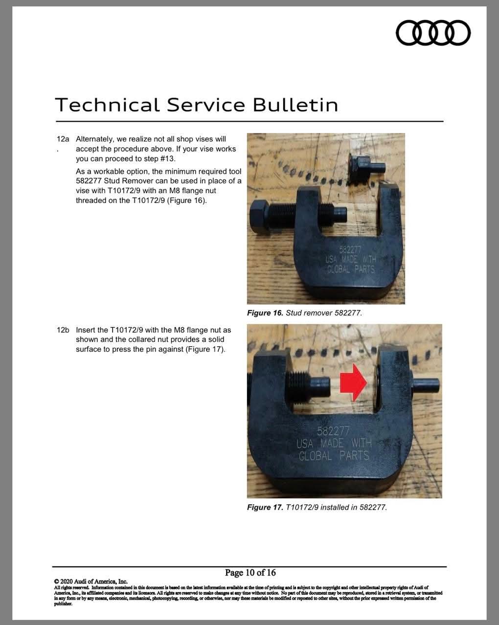

Related Service Information:
These fault codes are related to the AWD (quattro) clutch system.
Check the AWD clutch oil condition and level.
Inspect for contamination, overheating, or internal wear.
Perform adaptation/calibration of the AWD clutch using a diagnostic tool.
If the issue persists, replace the AWD clutch pack or control module.
In many cases, these faults are caused by internal clutch wear or sticking due to oil contamination or degradation.
