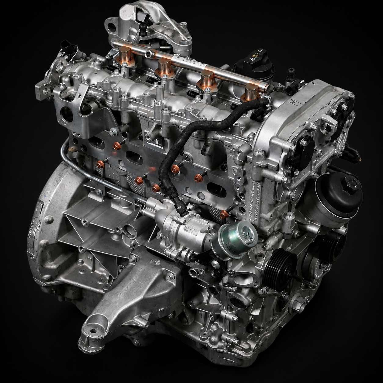

Mercedes-Benz M274 Engine: 3 Common Failures and Their Related DTCs
The Mercedes-Benz M274 is a widely used 2.0L turbocharged gasoline engine found in many C-Class, E-Class, GLC, GLE, and other models. While it is generally a reliable engine, several components are known to fail repeatedly as mileage increases.
