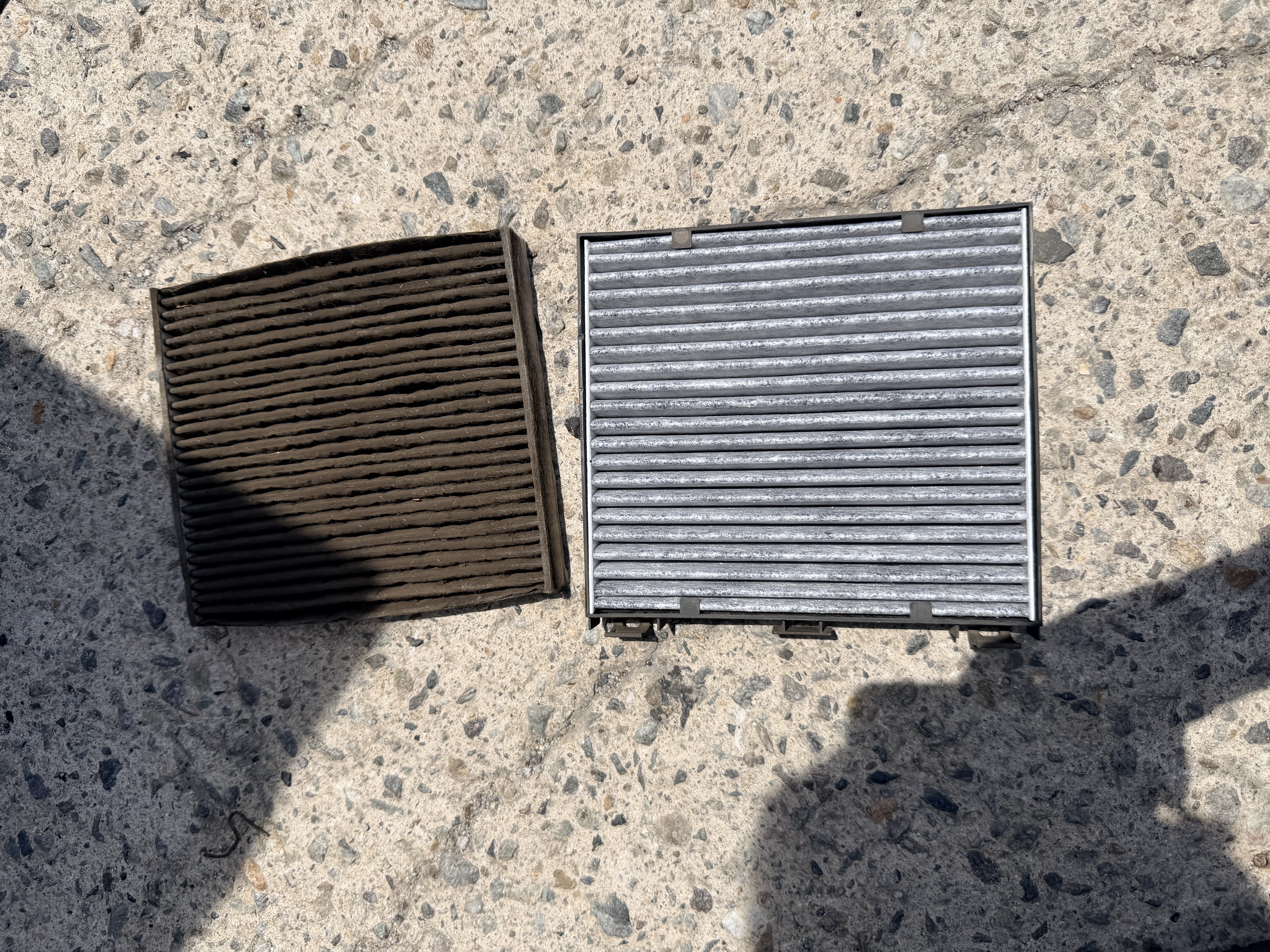

๐จ Weak Airflow from Your A/C? Check the Cabin Air Filter First.
If the air coming from your vents feels weaker than it used to, it doesnโt always mean the blower motor or A/C system has failed.
One of the most common causes is a clogged cabin air filter.
As shown in the photo, when the filter becomes packed with dust, pollen, and debris, the blower motor may still be operating normally, but airflow is restricted because air can no longer pass through the filter efficiently.
Typical symptoms include:
- Reduced airflow even with the fan set to maximum.
- Increased blower noise with little improvement in airflow.
- Weaker cooling performance due to restricted air circulation.
Of course, the cabin filter isnโt the only possibility.
On some vehicles, a faulty air distribution (mode door) actuator can prevent the HVAC doors from moving correctly, causing airflow to be split between different vents and making it feel much weaker.
However, in real-world workshops, a dirty cabin air filter is by far the most common cause of poor airflow.
The cabin air filter is more than just an air cleaner. It helps maintain proper airflow, reduces strain on the blower motor, and improves the air quality inside the vehicle.
Before replacing expensive components, take a few minutes to inspect the cabin air filter. A simple filter replacement is often all it takes to restore strong, fresh airflow.*
