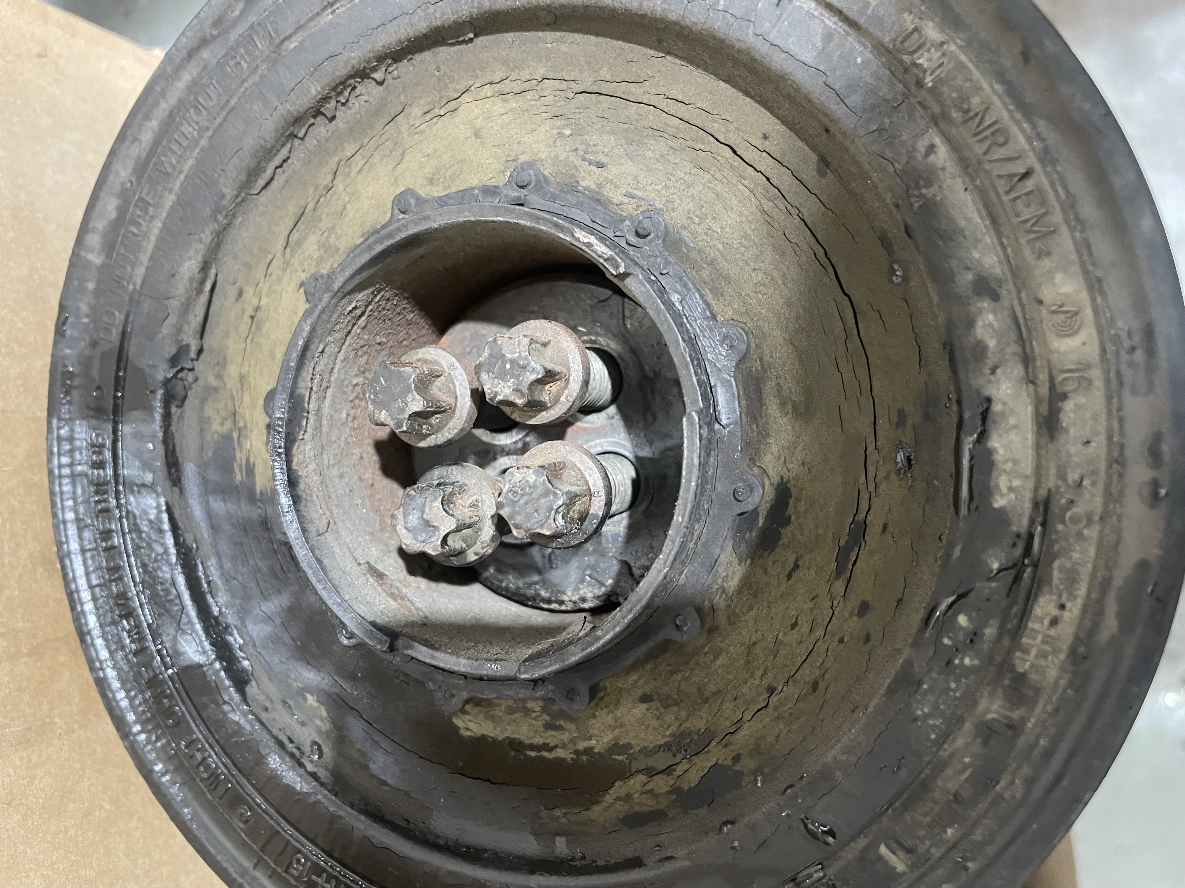

The crankshaft damper pulley, also known as the harmonic balancer, uses a rubber layer bonded between two metal sections to absorb crankshaft torsional vibration.
Over time, heat, engine oil contamination, and constant vibration cause the rubber to harden and crack. Once visible cracks appear, replacement should be considered.
Although BMW does not specify a fixed replacement interval, many technicians recommend inspecting the damper after 100,000 to 150,000 km (60,000 to 90,000 miles) or 8 to 10 years.
Diesel engines typically experience greater torsional vibration than gasoline engines, making damper wear more common.
Does Start-Stop Affect Damper Life?
Yes, it can.
Every engine restart creates a sudden torsional load on the crankshaft. Since the damper absorbs these forces, vehicles equipped with Start-Stop systems may experience accelerated rubber fatigue over time.
It is not the sole cause of failure, but it can contribute to faster aging.
What About MINI?
MINI models sharing BMW engines, including the B38, B48, and B47, commonly experience the same issue.
Frequent city driving, repeated engine restarts, and high underhood temperatures can accelerate deterioration.
Signs of a Worn Damper
- Visible cracks in the rubber
- Rubber separating or bulging
- Pulley wobble at idle
- Drive belt tracking off-center
- Squeaking or knocking noises during cold starts
Replacing a worn damper before complete separation can prevent belt failure, charging system problems, and expensive secondary damage.*
