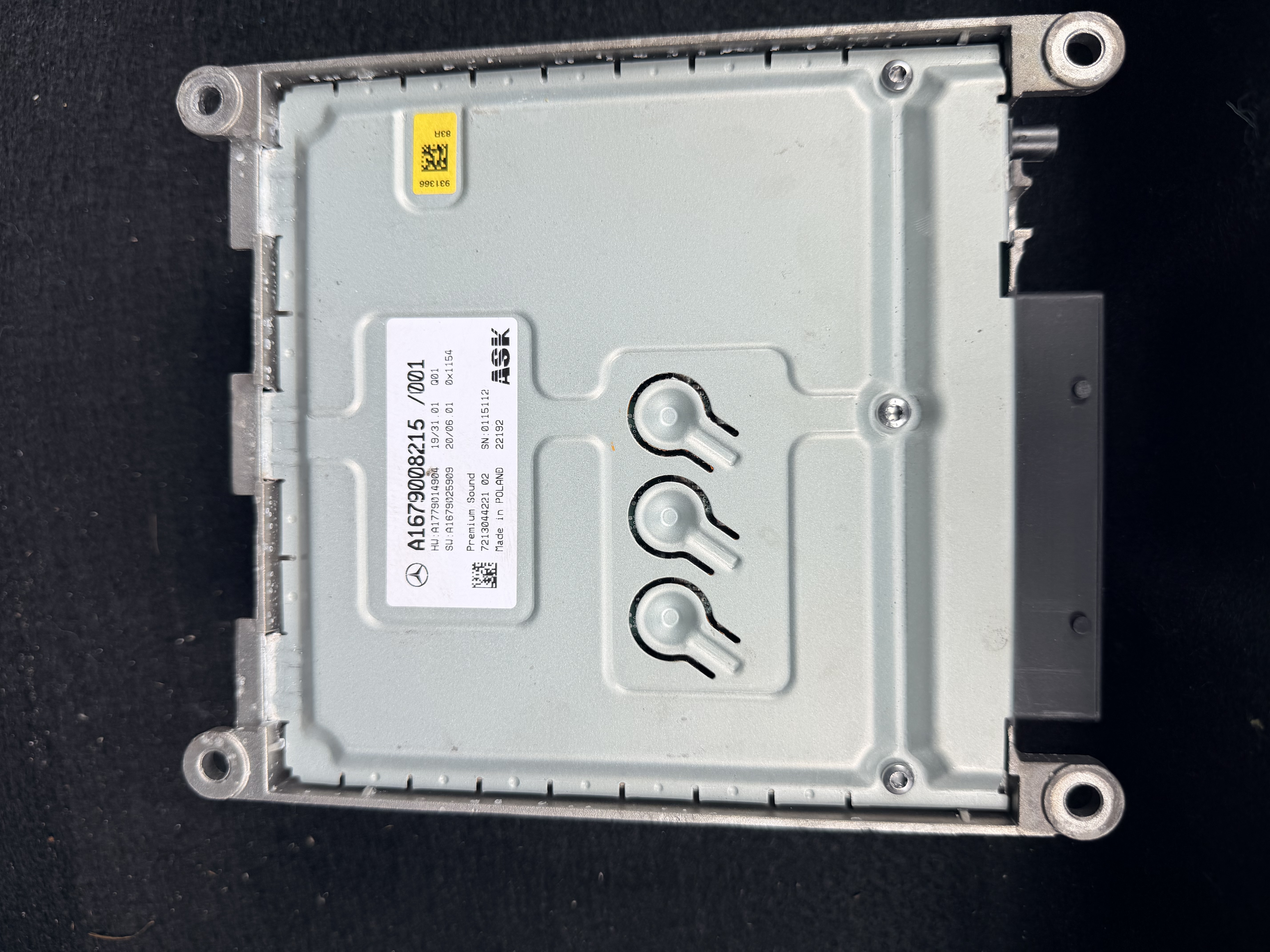

One issue that appears more often than many owners expect is water damage to the Burmester subwoofer amplifier located in the trunk.
When the audio system suddenly stops working, produces distorted sound, or multiple electrical faults appear at the same time, this amplifier is worth checking before replacing other components.
The amplifier is mounted on the floor of the luggage compartment, making it one of the first electronic modules exposed if water enters the trunk. Because the housing is designed for heat dissipation rather than being completely sealed, prolonged exposure to moisture can lead to internal corrosion.

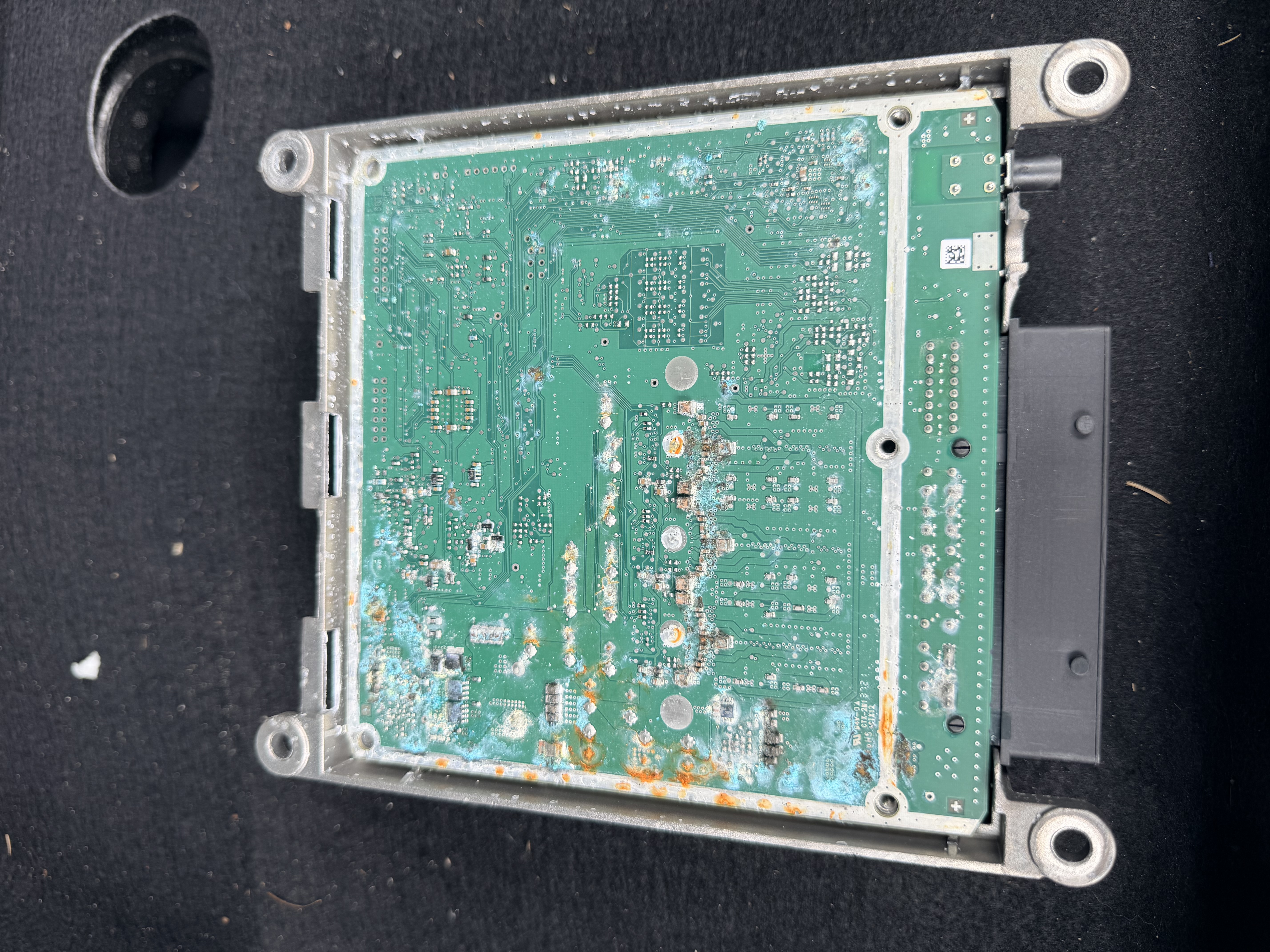

As shown in the photos, once moisture reaches the circuit board, corrosion quickly develops on the PCB, solder joints, and electronic components. At this stage, simply drying the module is rarely enough. In many cases, professional repair or replacement becomes necessary.
