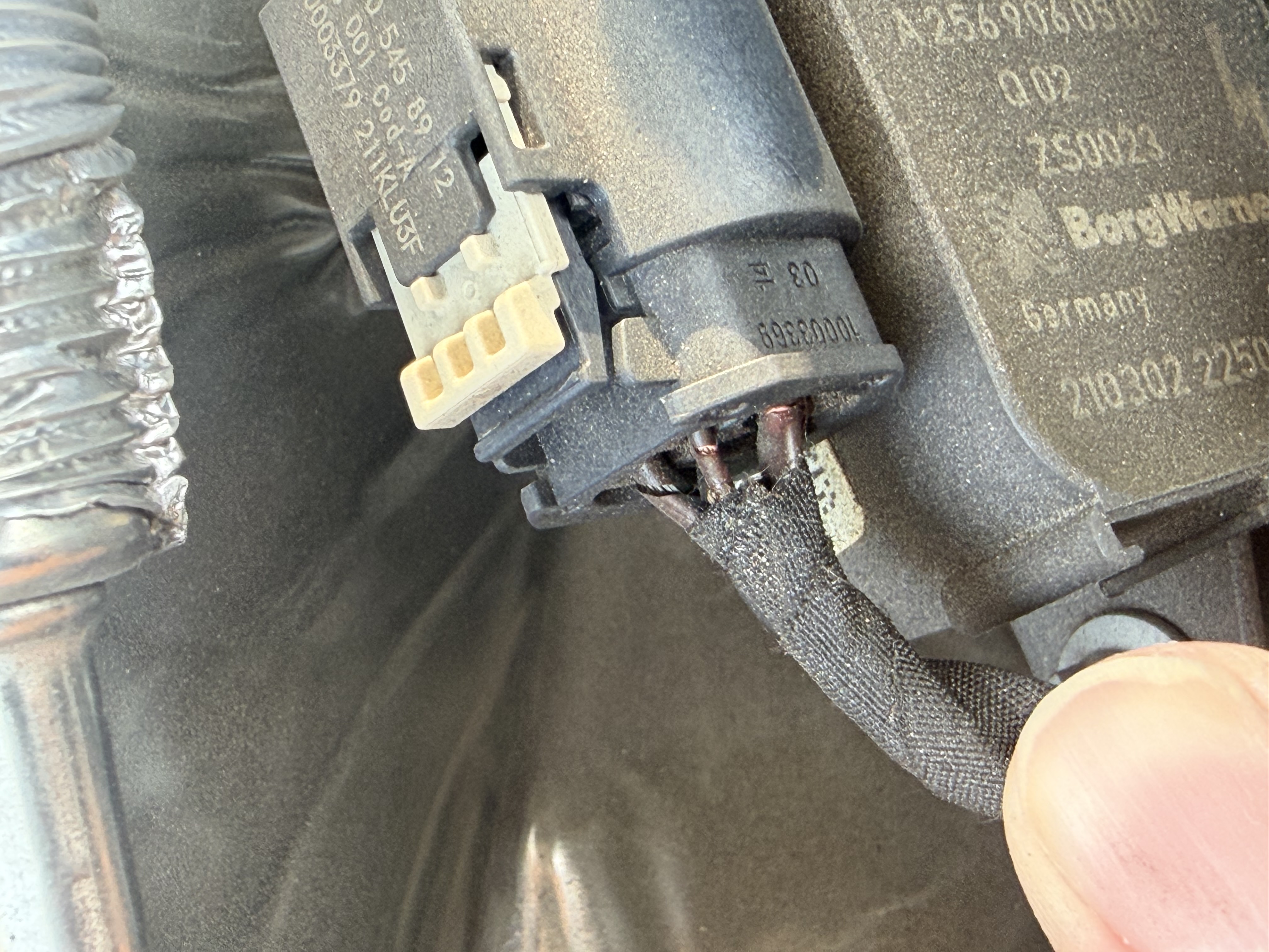

🔧 Why Do Engine Wiring Harnesses Become Brittle?
When disconnecting electrical connectors in the engine bay, you’ve probably seen wiring insulation that has become hard, cracked, or brittle. This isn’t always caused by age alone. It’s usually the result of years of exposure to heat, vibration, and the harsh environment under the hood.
The biggest factor is heat.
Every time the engine warms up and cools down, the wiring goes through another heat cycle. Components located near the turbocharger, exhaust manifold, EGR system, or coolant pipes are constantly exposed to high temperatures, causing the insulation to lose its flexibility over time.
Engine vibration also plays a major role. The section of wire closest to the connector flexes every time the engine moves, making it the first place where cracks develop and, eventually, where the copper strands inside may begin to break.
Another common cause is oil contamination. Long-term exposure to engine oil, coolant, transmission fluid, or cleaning chemicals can accelerate insulation deterioration and shorten the life of the wiring harness.
Common Symptoms
✔️ Intermittent check engine light
✔️ Recurring sensor fault codes
✔️ Fault appears or disappears when the harness is moved
✔️ CAN communication errors
✔️ Hard starting or reduced engine performance
Even if the outside of the wire looks acceptable, the copper conductor inside may already be damaged or partially broken.
How to Prevent It
✔️ Repair oil leaks as soon as possible.
✔️ Make sure all wiring clips and retainers are installed correctly.
✔️ Keep wiring away from exhaust components and other high-heat sources.
✔️ Use heat-resistant protective sleeves in areas exposed to excessive temperatures.
✔️ Never pull on the wires when disconnecting a connector. Always grip the connector body.
✔️ If the insulation is cracked or brittle, don’t rely on electrical tape. Repair the damaged section properly or replace the affected wiring harness.
As vehicles age, especially beyond 10 years, wiring harness failures become increasingly common. In many cases, the wiring is the real culprit, not the sensor itself.
Before replacing expensive sensors, always inspect the connector and wiring harness carefully. A few minutes of inspection can save hours of unnecessary diagnostics and repair costs.*
