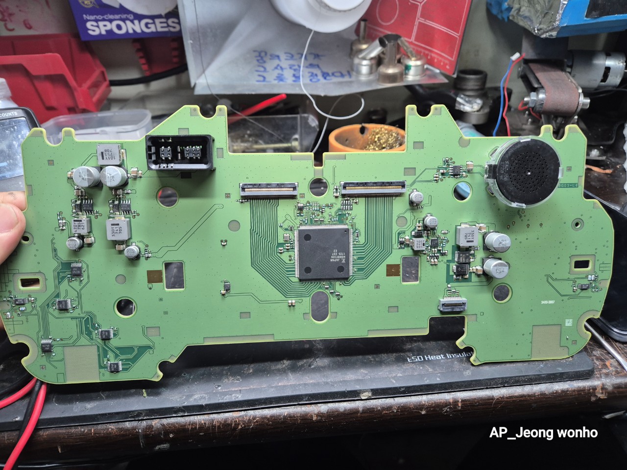

[BMW] How to fix the black screen issue on the BMW G Body ID6 instrument cluster
👤 fassing
11

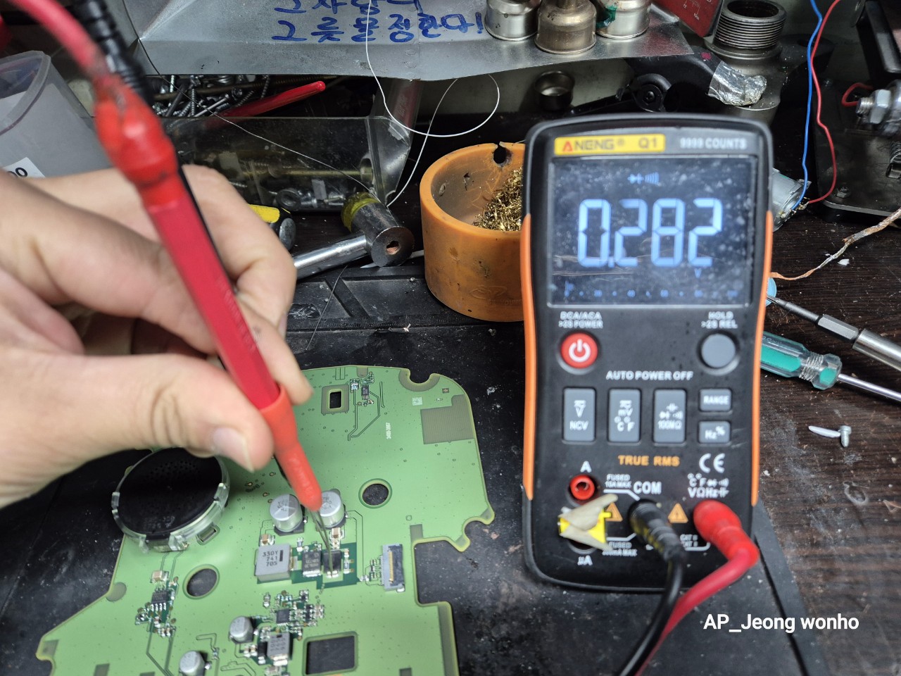

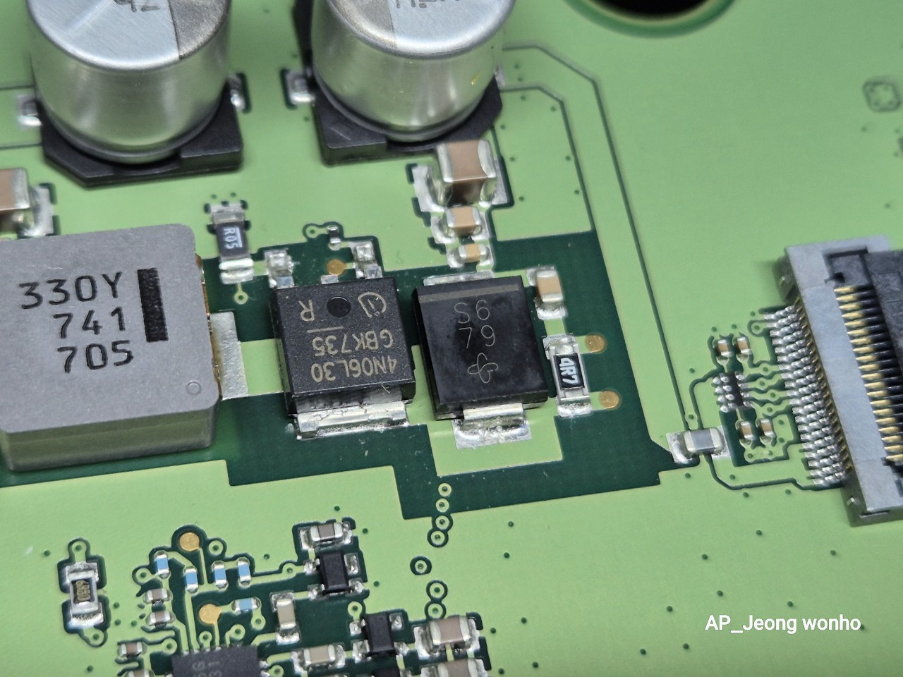

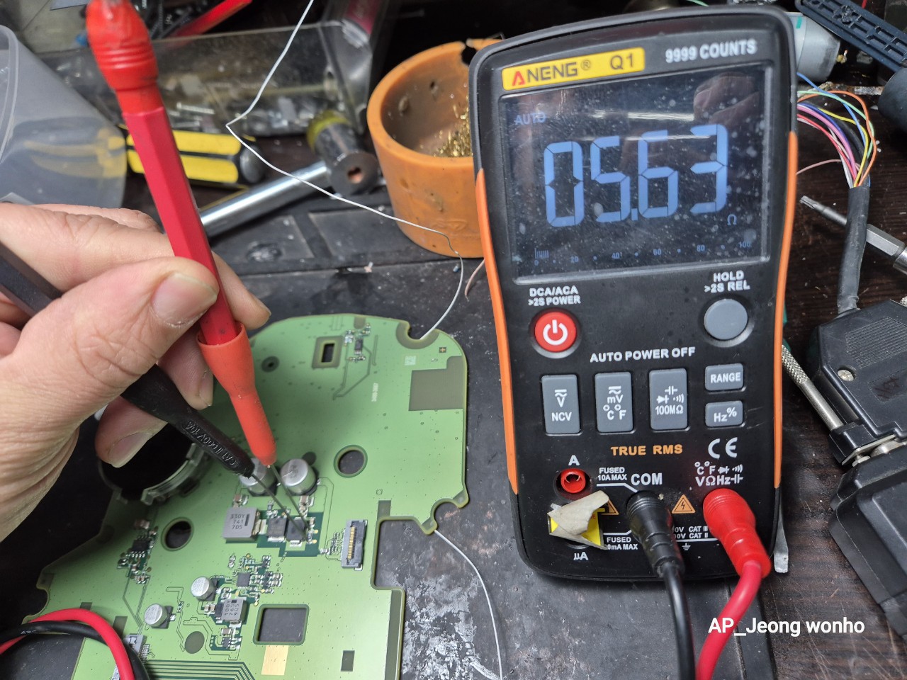

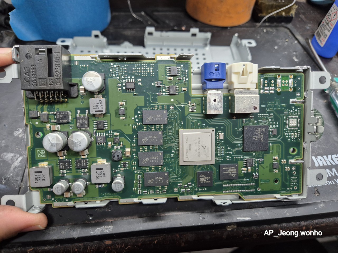

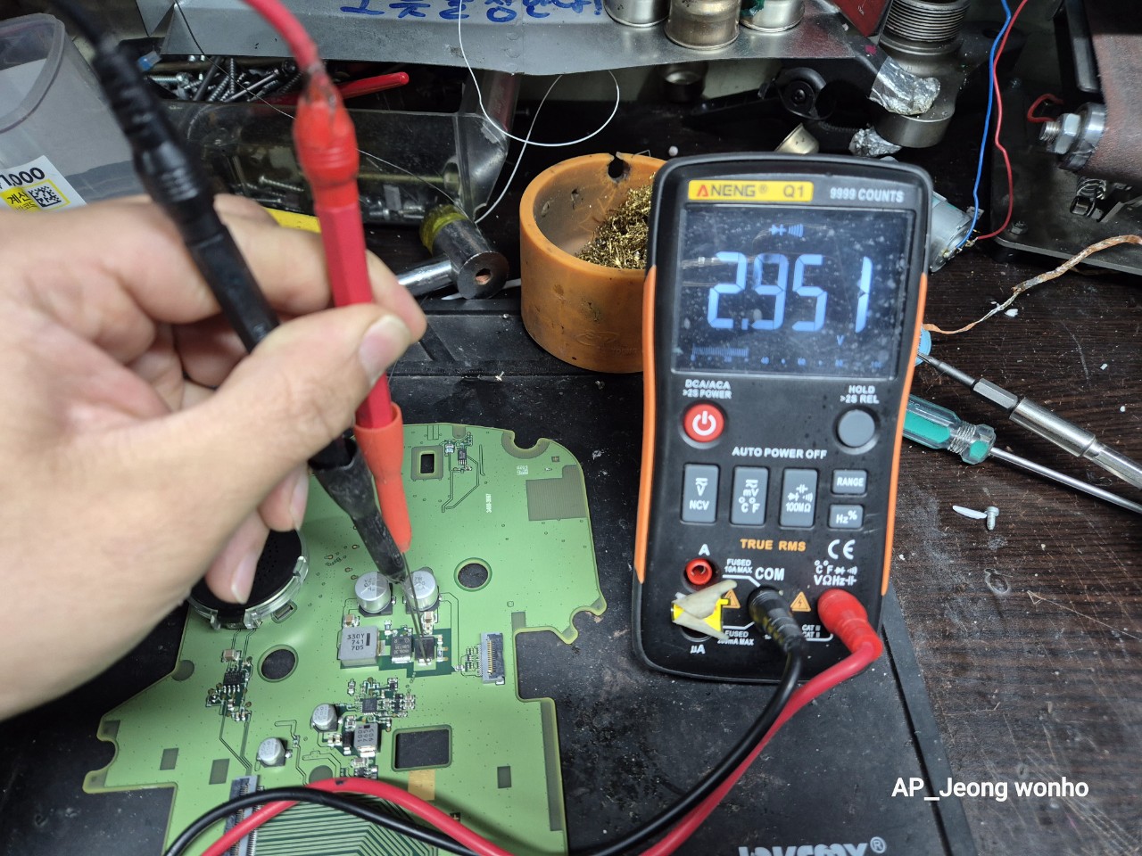

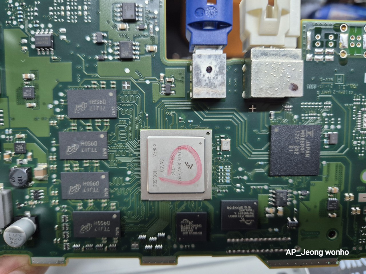

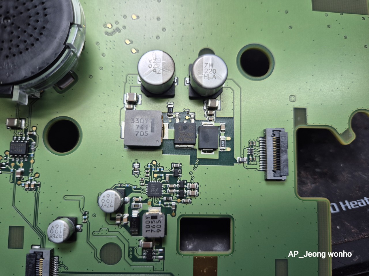

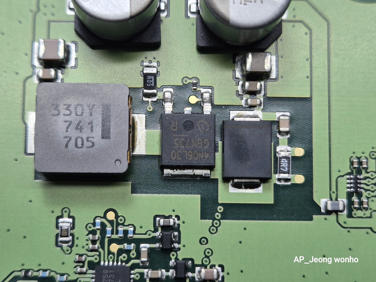

If the MOSFET chip issue is resolved, you can re-heat it with a BGA solder short circuit
