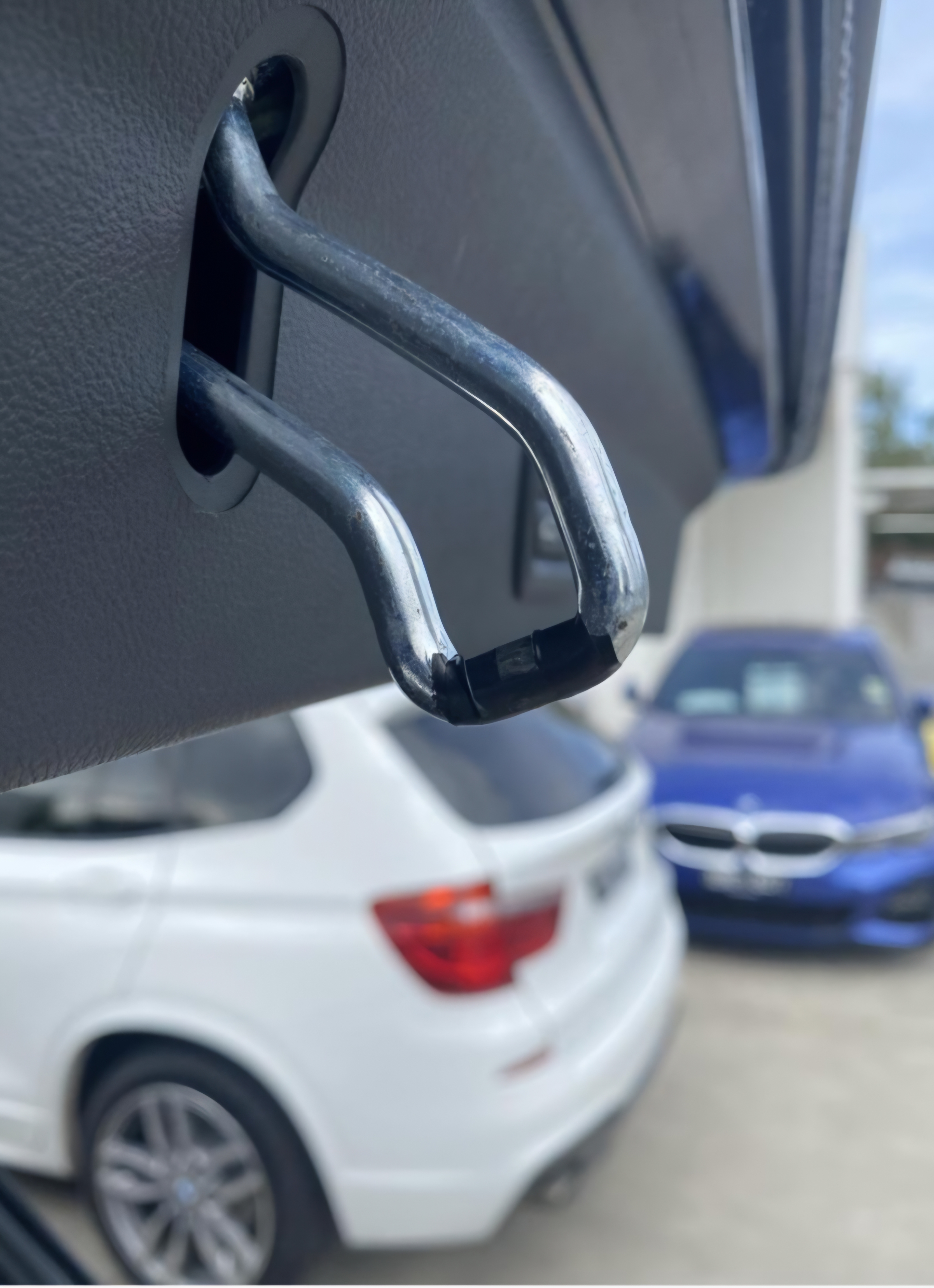

When I press the plastic part where the trunk lid is attached, it makes a creaking sound. Could this be the cause?
I got home and had it serviced, and the mechanic immediately noticed the squeaking sound. I was told that squeaking or rattling noises are only covered under the one-year warranty.
Anyway, he did fix it, but it was a bit surprising that he fixed it just by applying tape and lubricant. Adam, the mechanic, said he does the exact same thing on his own X5.
