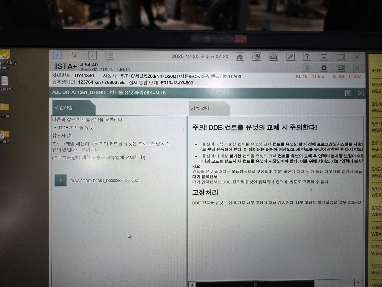

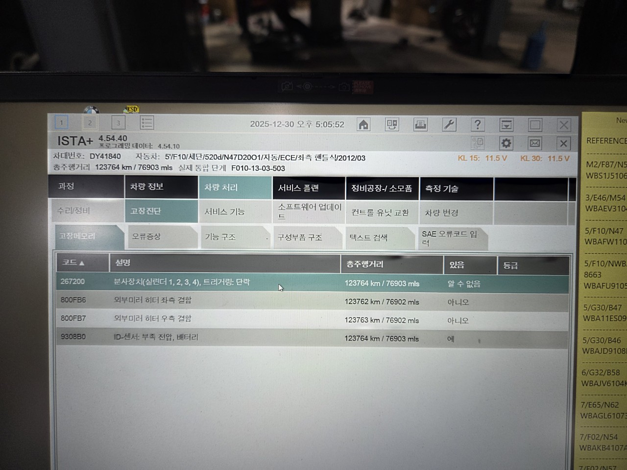

DME dispensing unit (cylinders 1, 2, 3, 4), short circuit to trim
Suspected ECU failure, but short circuit to the injector control wiring
Don't blindly trust the test plan and do a basic check
