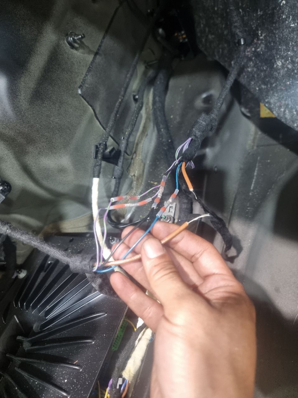

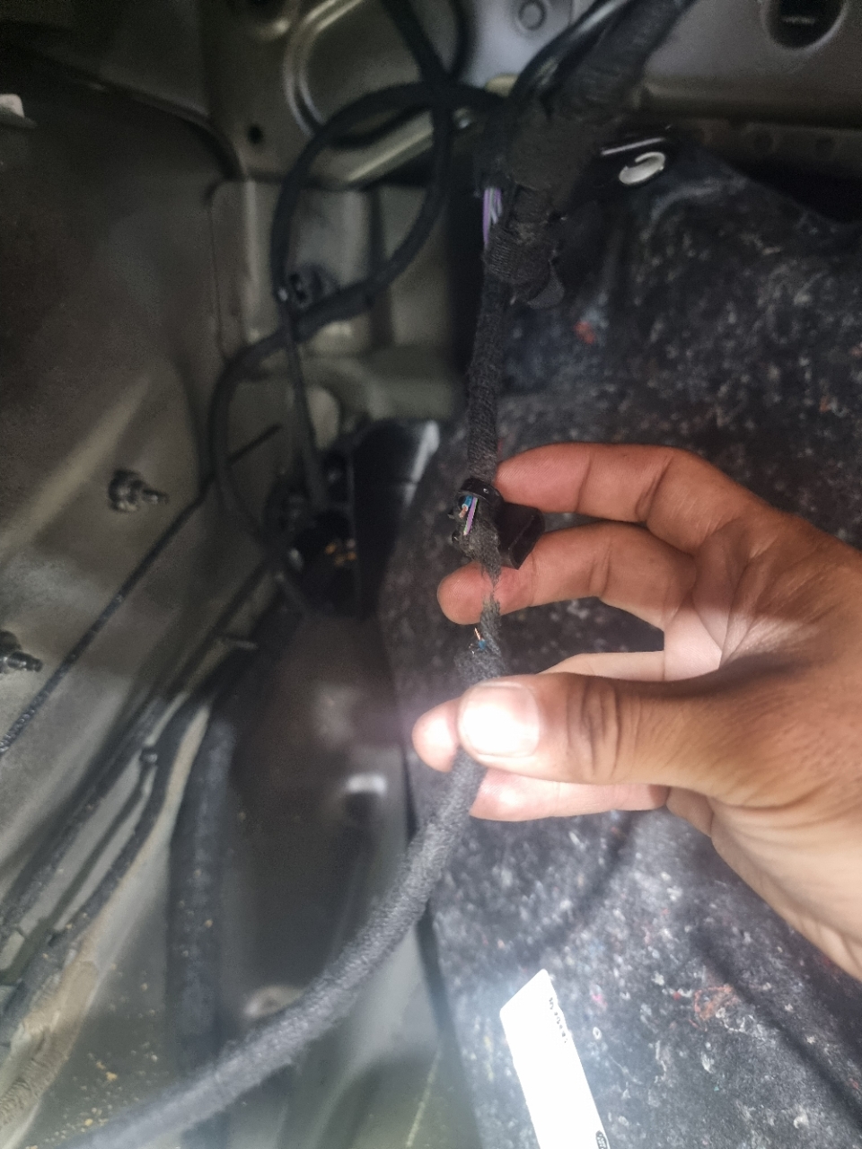

🔧 Trunk Hinge Wiring Failure: Design Flaw or Structural Limitation?
A broken wire inside the trunk hinge area is one of those faults that technicians encounter more often than many people realize. It is commonly seen on Volkswagen, Audi, BMW, Jaguar, Land Rover, Volvo, and many other brands.
The reason is simple. Every time the trunk opens and closes, the wiring harness bends and flexes in the exact same location. Over thousands of cycles, the copper conductors inside the wires begin to fatigue and eventually break.
What makes diagnosis difficult is that the outer insulation often remains intact. From the outside, the wiring may look perfectly fine, while the copper strands hidden inside have already fractured.

In many cases, owners suspect a failed control module, only to discover that the root cause is a damaged wire hidden inside the hinge area.

For vehicles that are 7 to 10 years old or older, trunk-related electrical faults should always include a wiring inspection before replacing expensive modules or components.
Sometimes the cause of a major electrical problem is not a failed control unit, but a single broken wire hidden deep inside the trunk hinge.
