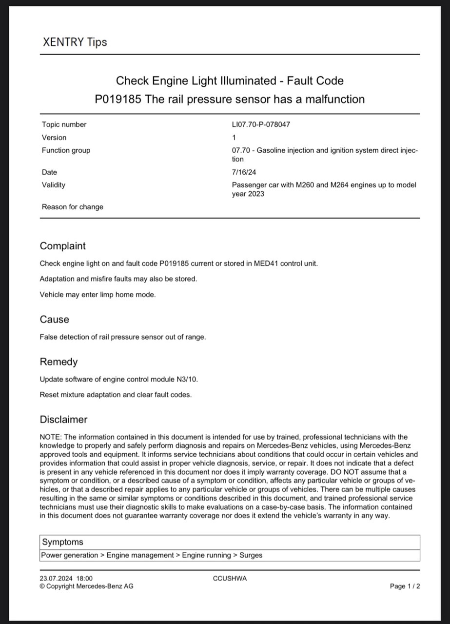

적용 모델 :
2023년까지 생산된 M260 엔진
2023년까지 생산된 M264 엔진
증상 :
엔진 경고등이 점등되고, FC P019185가 MED41( ME
)에 저장되어 있음
어댑테이션 또는 실화에 대한 고장코드가 동반되기도 함 출력제한이 걸리기도 함
원인 :
MED41에 설치된 소프트웨어 에러로 인해서 레일압력센서의 출력값이 규정값을 벗어났다고 연산
해결책 :
MED41을 업데이트 한다.

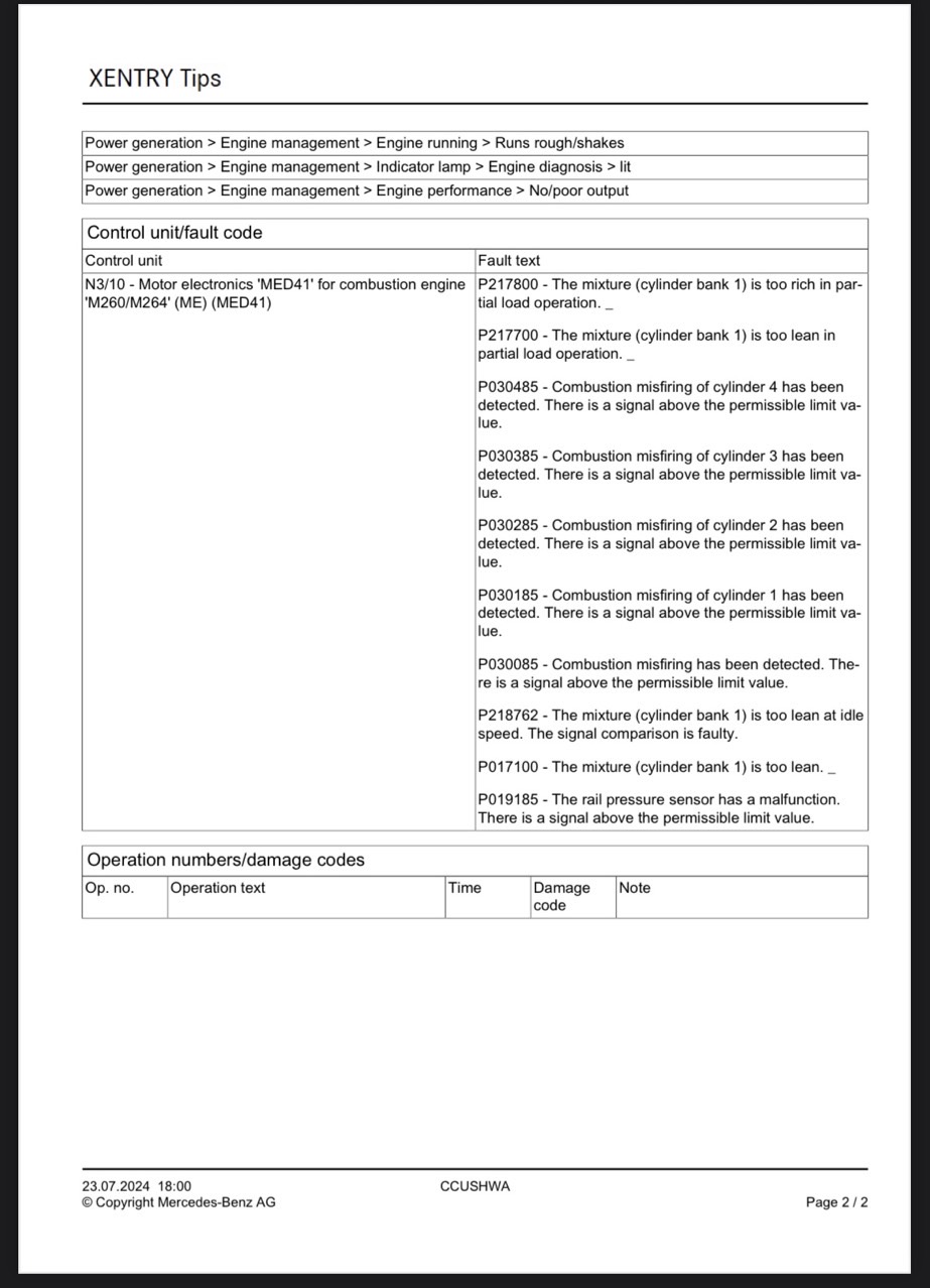

FC P019185와 동반 될 수 있는 고장코드 리스트
P217800 - The mixture (cylinder bank 1) is too rich in partial load operation.
P217700 - The mixture (cylinder bank 1) is too lean in partial load operation.
P030485 - Combustion misfiring of cylinder 4 has been detected. There is a signal above the permissible limit value.
P030385 - Combustion misfiring of cylinder 3 has been detected. There is a signal above the permissible limit value.
P030285 - Combustion misfiring of cylinder 2 has been detected. There is a signal above the permissible limit value.
P030185 - Combustion misfiring of cylinder 1 has been detected. There is a signal above the permissible limit value.
P030085 - Combustion misfiring has been detected. There is a signal above the permissible limit value.
P218762 - The mixture (cylinder bank 1) is too lean at idle speed. The signal comparison is faulty.
P017100 - The mixture (cylinder bank 1) is too lean.
